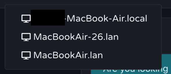

I’ve been having an issue where AW keeps making new hostnames. I wanted to merge the buckets all into one, but the available documentation out there was unhelpful. I figured out a process that worked for me to merge buckets and fix my hostname, but it took me forever to piece it together because I’m an utter noob, so here’s a step by step. I do not know if it will work for you, I just hope that this saves someone at least some time.
The Problem
I had AW already installed and working. However, I kept seeing new hostnames in the upper left of the UI. I don’t know why this happens, apparently it’s a known bug.
I wanted to merge these into one because it was really annoying having to open three different buckets to see what I was doing.
