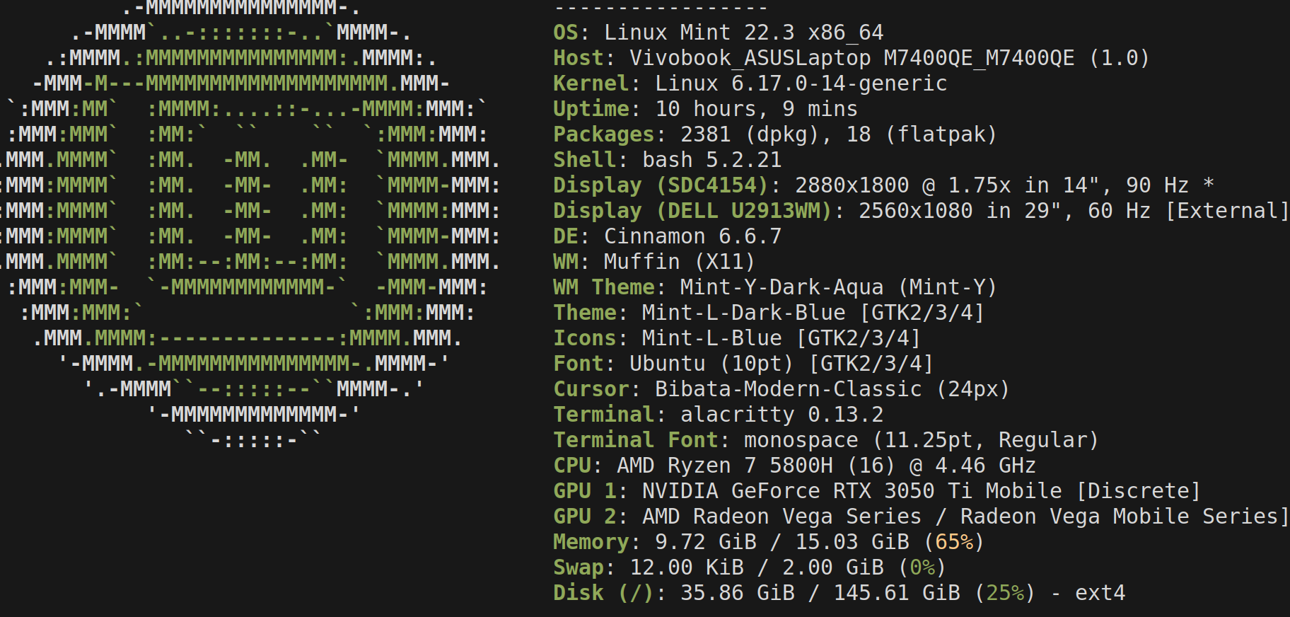

I’m probably not going to keep poking at it here, I’m going to switch to a different flavour of OS, but in case it’s useful, something could be falling over for users of Mint Cinnamon, identical to the report in issue #1033, reproducible on the live boot of Mint Cinnamon 22.3 on the below hardware.
